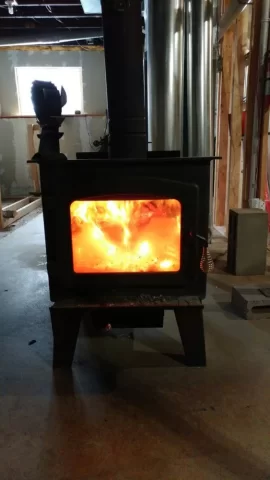

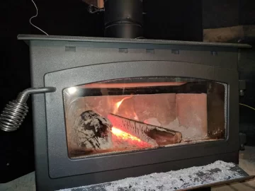

Got any pics of this stove? I can't picture this model.

Good to hear that it's on track... Not sure I love this stove, but it does hear the place up!

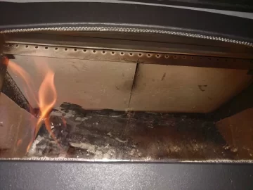

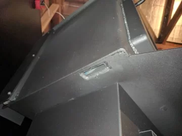

Thanks for the pics
I'm not seeing secondary air tubes along the top of the burn chamber. Instead of being an EPA approved stove I'm guessing it is an EPA exempt unit, and that is why you don't have air controls.
The exempt units are considered a fireplace and allow extra air in to make a cleaner burn.
If it is installed to spec, for an occasional heater it should do fine.
If your goal is 24/7 burning, and you have well seasoned wood an EPA approved stove with air control would serve you better in the long run.
Have fun playing with the new toy!

Thanks for the pics
Actually it does have secondary air tubes, the rectangular hole on the bottom in the pics above show the intake, here's a photo of the actual tubes.

That is interesting for certain!
Hmm, wondering why this is setup this way.

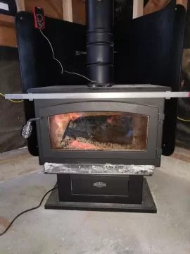

Any chance you could post a video to show what it looks like through the window when your stove is in cruise mode? Mine looks like this right now running around 480
https://goo.gl/photos/6Gue4kFQttdDXJnV8
That's flue t about 50% and primaries at about 50%
Sent from my Pixel using Tapatalk
Hi Graelb. Sorry I didn't see your post last night before turning in. Here is a picture of my stove in cruising mode this morning. It has been running for about an hour when I took the picture. The stove top is running between 680 F and 725 F taken from various points on the stove top. The flue is running at 385 C which converts to 725 F.... Hope this helps. It sounds like your stove is being a real pain in the butt right now eh? That can be very frustrating. How many sticks of wood did you have in it when you were running it last night before it died out? I'm wondering if you might need to load it with 4 to 6 splits in order to get it going good and keep it self-sustaining? I'm not an expert though, but I'm sure someone around here could chime in and help you with your operating issues. Perhaps you could start by explaining your whole set up exactly from the stove right up to the chimney cap, and maybe give us an idea of how dry your wood is.... Details help in trouble shooting... And your in the right place to get things sorted... Chin up! :-)

Well I can't seem to get the video uploaded so the best I can give you is the picture above. Better than nothing though... :-)
