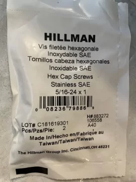

Pic 1 - original bolts and washers

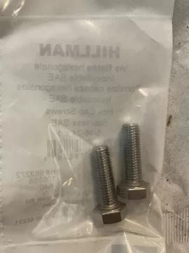

Pic 2&3 - new stainless steel 5-16”-24 x 1” long from Lowes

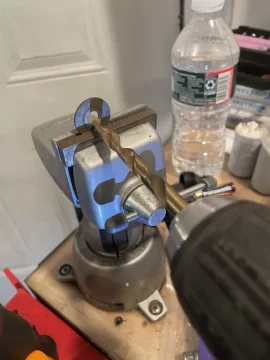

Pic 4&5 - Drilling out original steel washers to 5/16 inside diameter for new larger bolts

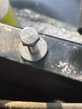

Pic 11&12 - It worked!!
