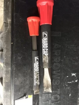

[Hearth.com] M55 cast As nailed_nailer said, you could have a good carbon buildup on the burn pot liner that the end of one of the agitator ends chips off from time to time. Here are the two tools I use to clean my line. The big one, 3/4” is my walking tool, I usually walk all around the bottom of the liner to break off the carbon. Then I use the small one, 1/4” for a fine scrape. It usually takes about 2 minutes or less, once a week. Good luck, Bill
