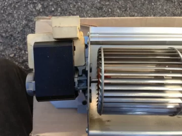

Thee have been lots of posts in the past two years concerning overheating issues with the M55 insert and its over heating issues. Here is a photo of the problem. If you look at the shaft from the motor going in to the tangential fan you'll see it's crooked. The weight of the motor causes the motor itself to sag which slows down the RPM thus causing the issue. FYI this motor came out of a Vista Flame M55 FS. Really, any M55 stove with this motor will eventually garner this issue. [Hearth.com] M55 convection motor issue
Excellent photo! Is there a cure for this? What supports the motor?

No Don, that motor will not fit on this stove. I know the motor you speak of. It's too small. I think the new motor replacement is 230 cfm or so and about 7 inches longer in width

Enviro makes many different tangential blower. We have the 50-2481, EC-069, 50-1455, 50-1217, 50-2346, and the 50-2260. Each is used in different stoves. That doesn't include the double housing blowers or the EF-002. The problem with the older M55 convection blowers has been solved in the newest generation which work just fine and we haven't had any warranties on at all.

Thee have been lots of posts in the past two years concerning overheating issues with the M55 insert and its over heating issues. Here is a photo of the problem. If you look at the shaft from the motor going in to the tangential fan you'll see it's crooked. The weight of the motor causes the motor itself to sag which slows down the RPM thus causing the issue. FYI this motor came out of a Vista Flame M55 FS. Really, any M55 stove with this motor will eventually garner this issue.View attachment 107752
Similar problem, my blower was making noise, found it was coming from the blower/motor, same deal, motor on an angle. Gasket (or is it a bearing? pink piece inside the blower) is cracked. Can that piece be replaced? hope i dont have to replace the entire blower assembly....but if I do, it wouldn't hurt to get the turbo blower.
