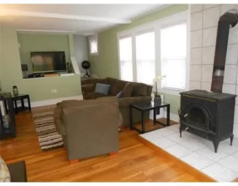

Hi all, new here and to wood stoves. Hoping I can get some help. Haven't been able to figure it out.
I just bought a house and right before closing the seller told us that they didn't actually have a permit for the wood stove. She said that she had the fire inspector come in and he said it needs around another foot of clearance in the front.
Reading the MA laws it seems like you need 36" of clearance all around, but as long as the stove was installed to the guidelines in the manual it should be all set for reduced clearance. Can anyone help clarify this for me. Am I understanding wrong? I would like to know before sure before I call the inspector up and make a fool of myself.
It's a Dutchwest convection heater 2461
Here's a picture of the set-up.
[Hearth.com] MA permit question
Also I need to get a new refractory package. The one that is there is wicked damaged. Anyone know where I can get one quick, and not spend an arm and leg?
Thanks in advance!

Sorry, I can't help you with the regulations questions, but I can tell you this. I always use the side door for loading and if you choose to do the same, you will want more protection than I see there.
The manufacturers specifications over ride the code. You will need an owners manual to show the inspector.

I would be concerned about that stove. By the looks of the stovepipe it looks like it was run pretty hard.

What is behind the tile behind it? Is it the brick and mortar of a chimney or is there framing between the tile and the chimney?

Finally made some progress here. Thanks for all the responses. I got in touch with the fire inspector and he couldn't begin to figure out why he would have said it needed another foot in front of it. He said just what the manufacturer says.
I also had a certified chimney sweep come in and inspect and clean it. He said the stove is in great condition, and everything has been clean. He also said that the pipe is fine. He checked it all out though and said besides looking ugly it had no problems. He took it all apart and everything. I also have myself wondering if I broke the refractory package in the first place...
I've also got it all insured and covered.
SOOO I guess I'm good to go.
