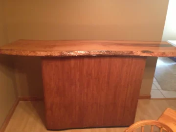

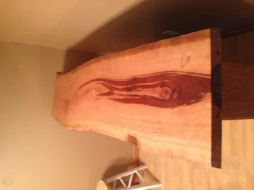

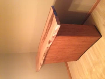

I finally did something with some slab wood that I cut a couple of years ago. My son bought a new condo and I had made a bar many years ago out of Pecky Cyprus and he wanted to know if I could make him one. I hand plained and belt sanded the slab and used an epoxy finish. It turned out great and I now it has me thinking of other projects since I did cut up several slabs of Oak and Cherry. I also have some monster Ash to cut up. I went online and checked the price of slabs like this and was amazed how much they sell for.

G and W - the images that are being linked from "Sellyouroldcoins" is asking for a sign-in. You will probably need to save them local to your machine then upload to hearth from there.

I hear ya, believe me my son is a WVU graduate and they know how to party. Figured we better get a picture before it is all partied up.

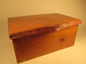

Here is a natural edge cherry box from a milled end plank that I made a few weeks ago.
