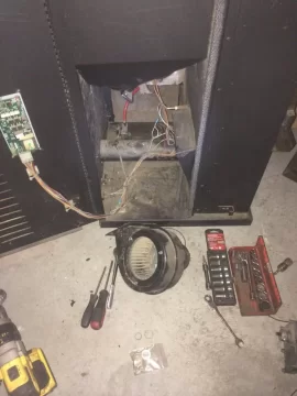

Working on a BC-AC in my new workshop right now! The Delron auger bearing was toast! See the old one in 2 pieces above the new set on the plastic bag!
See pic

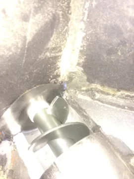

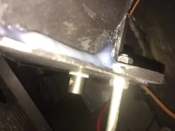

Just buffed out the auger with a wire wheel, sprayed the auger down with "Dry Moly" and installed a new top brass bearing and a new Delron bottom bearing. Also used high temp CLEAR RTV on the auger end plate for good looks. :)
Auger turns like a knife thru butter by hand!
See pics

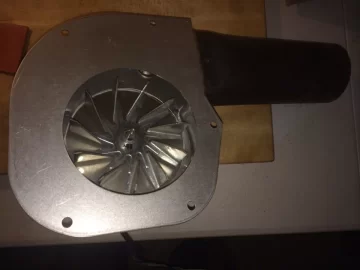

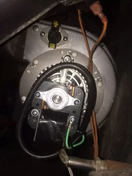

Hello
I am also putting in a super upgraded exhaust blower for this baby.
See pics. How does it look?

Hello
What kind of blower is that Don? Someday I want an upgrade so I don't have to plug my air wash.
