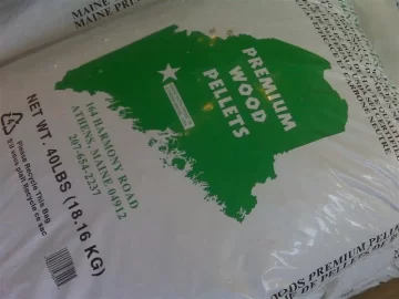

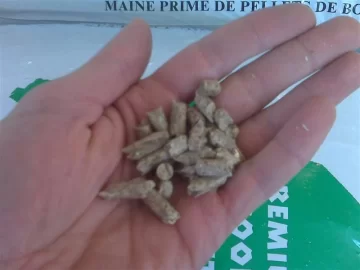

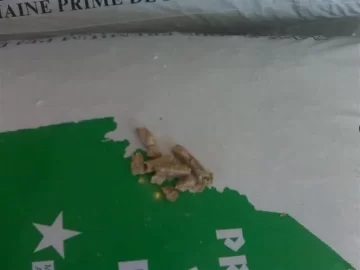

We were at the store this weekend picking up a few things. They had a bag open so I took a few pics. I took the pics with my BlackBerry, so it's not digi-cam quality. Are these the decent ones?
skier76,
yes these are the decent ones. i burned these last year (6ton). the worst of them were the first of production, that i bought in oct. when i went back in dec. for 2 more ton, the quality was better.lighter in color and held together making a more uniform pellet. the ash content is high but not a problem for me as i clean every week regardless of my ash box. feb i went for another 2 ton and the quality was as good if not a little better. that said, i will go with mwp again this year. i would like to go to cubex but cant afford 300 per ton.
