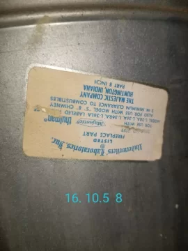

I recently bought a ranch home that has 2 full length 3wall non insulated chimneys installed. Id like to hook up my woodchuck 2900 to the chimney. I am a bit confused because both 8 inch chimenys are identicle and placed 5 inchs apart. One has suit. The other appears to never been used. It appears these chimneys are prob 30 years old. Is there any reason I cant use the new appearing chimney?

The label does not say what up standard it is listed to but it does state that it is made to be used with prefab fireplaces which typically do not use chimneys listed to ul 103 ht. And regardless without insulation the chimney is air cooled. This will cool the fluegasses leading to more creosote buildup than if it was an insulated chimney. I personally would not use it.
From what I found these were used on specific Majestic fireplaces. The instructions for those fireplaces don't have any specific chimney listing info and specifically state that any UL listing information would have been on the fireplace however the installation instructions for the chimney were included. Being that they are that old and have no documentation to verify anything against I would concur with bholler that they shouldn't be used. Your insurance company may have a similar opinion if they were aware of the same facts.
