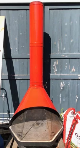

The plan was to install this vintage majestic in our new screened porch. The dilemma as you have read is the 9"ID stack…
[Hearth.com] Majestic headache (ISO 9" dblwall)
Is it bad idea to drop down to an 8"? Any recommendations on where to find 10" that doesn't cost 3 toes?
Any suggestions appreciated!
Thanks,
Most good chimney manufacturers make 9 and 10" but it is not commonly used so it wont be cheap
