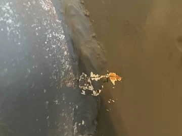

Good morning, we purchased a Mama bear to install, but noticed a few small hairline cracks near the back of stove and in pipe leading out. Was checking to see if these needed corrective action before installing or normal wear and tear with the stove, thanks so much!

Yes it absolutely needs fixed.
Looks like the outer half of outlet pipe has been replaced? It is normally one piece with no seam.
Stop drill cracks with 1/8 inch drill bit, about 1/4 or 3/8 inch away from crack end. (There is a microscopic crack you can’t see farther than the known crack) This will allow the crack to progress into the drilled hole. The radius of the hole stops the crack from progressing. V-grind and weld cracks.

Thank you for the reply, it does appear that the outer half was replaced, just feel really dumb I didn’t notice that. The crack in the center of the outlet pipe seems pretty significant, we’re talking about putting some drill holes in there and also on the back plate, near the seams of the outlet pipe?
Also any particular drill bit you’d recommend? Thanks again

Only stop drill the tiny cracks on the rear sheet. If you are not welding it yourself, the welding shop should drill and grind before welding.
