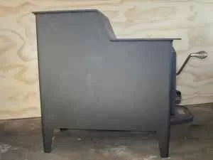

Hello all,
When I got this mama, someone had cut her legs down to around 4". None of the legs were the same length. I spent the past evening and this morning in the operation room.:) She now has a floor clearance of 6-1/4". They are "not" traditional but I think they look good, and are MUCH beefier then the originals. I hope you like them:cool:..... Coaly, forgive me _g I had to.......

That's OK, it's close to the VI style;
[Hearth.com] Mama has some new sexy legs [Hearth.com] Mama has some new sexy legs
That's nice work. Legs look just like they belonged there from day one. Rick
Good job Dave they look better than the original legs..

Yes Steve, got a few goodies, most of the stuff is old but still functional. Thank's "all" of you for the kind words, I couldn't stand looking at that stove with stubby legs anymore;ex
It looks great. That old brake will out last you;)
My apologies Steve, what your looking at in that one picture is a sheet metal sheer, Although there is a brake behind that in the back of the shop, "very" similar. The sheer is around circa, 1965 and the brake is older, maybe sometime in the 50's, All still work good.
I got an old drill press will be a boat anchor soon.........;)
That is a big sheer. Those older brakes and sheers were well made. My brother has a brake and sheer that my Dad bought used for his sheet metal shop back in 1958. Brother took over the business. It still works like the day he bought it. What gauge metal can you brake and cut?
That's a beautiful Mama. Love the Resto. Looks awesome.
Are you using all three Fishers in your Signature? Love looking at installs of them. My Uncles buddy down the street has a Papa and I often think about getting one for my shop or my Barn.
Hello Dexter, I'm using only one "for now" the Grandma. She has been cooking along for about 20+ years now. I did a baby bear restoration earlier this winter, It's going in a family room/dining area this spring/summer. I got the Mama from a guy who had it in storage, didn't want it where he was going.

Steve, the sheer is an old Niagara co. and will do up to 16ga. The brake from the same company, will do the same. We have an old finger break from the Budd co.? works real well, dated 1955 on the plate of mfg. It's all old USN hand me downs, thats mostly what the CG gets. I'm fortunate to have access mostly anytime at my leisure other than work time.
