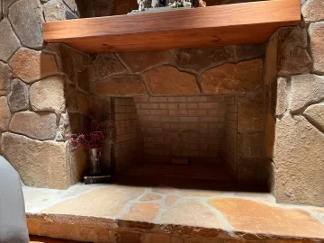

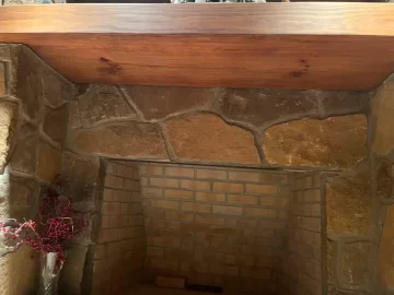

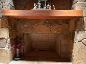

This sounds like a very large fireplace. A picture of the fireplace with dimensions would be helpful.
Reactions: Coldnga
Oy, I'm not sure why they did that. It's an awful design but I see the challenge now.
Reactions: moresnow
TERRACE LEVEL
Firebox inset dimensions
Width: 49” at front, 39” at rear
Depth: 25.5” at bottom, 15.5” at top
inward taper starts at 10.5” height
Height: 32” at front, 41.5” at rear
Stone fascia inset dimensions
Width: 66” at front and rear
Depth: 18” uniformly to firebox
Height: 49.5” hearth to mantel
Mantel dimensions
75” total width set in stone
Depth: 21” uniformly
Height: 6” uniformly

This was made mostly for show and not for go. Why trap a fire in a cave with a combustible shelf over it? In the least, the mantle should be made of a non-combustible material. That will simplify things. I don't know if this company does custom.
Whatever the solution, it will probably need sign offs from the stove manufacturer and inspecting authority.
Reactions: Coldnga
How about replacing the wood mantel with granite or some other stone? Would look nice and no longer combustible, right? Bet you could get an off-cut of granite from a local yard and get it cut to size, and beveled or square cut on the leading edge for less than $250.

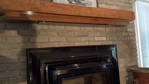

I have a PI 29. Attached is a picture of a heat deflector shield I crafted to divert some of the direct heat from the insert way from my mantle. Said mantle is only 8" wide however, yours looks wider. I used rockwool to seal the gaps between the brick and the shrouds. My mantle does get warm, but my IR thermometer shows nothing higher than 90 or so degrees. No visible marks on the wood so I feel ok.

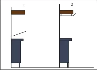

A mantel shield was suggested or replacement with a non-combustible mantel.
[Hearth.com] Mantel clearances? [Hearth.com] Mantel clearances?
The idea in illustration # 1 looks intriguing, would the heat dissipate beyond the edge of the mantel? I also wondered about the amount of heat generated from a gas log set up, would it be in the neighborhood of a wood insert or significantly less?
