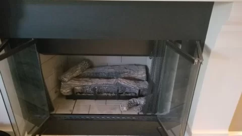

Hi,
I have a manufactured fireplace (Superior) and between the damper and log set there's this metal finned baffle or maybe heat shield like thing. I was wondering if someone could tell me what this thing is and it's purpose?
Thank you!
Randy

Gas fireplace? Looks like a turbulator of sorts.

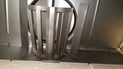

One more image. Could it be for heat retention? I'm thinking about crafting an insulated cover with safety hanging chain for the leaky damper and I was thinking about moving or altering it so I can more easily mount the cover.
[Hearth.com] Manufactured fireplace - What's this thing?
It may be an air flow restrictor to prevent turbulence around the pilot hood.
Too much unchecked airflow can agitate the pilot flame & move it off the
thermocouple, & shut the gas flow off.
