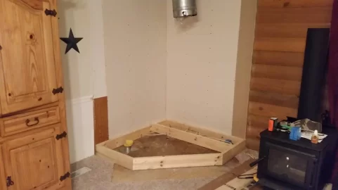

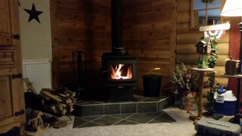

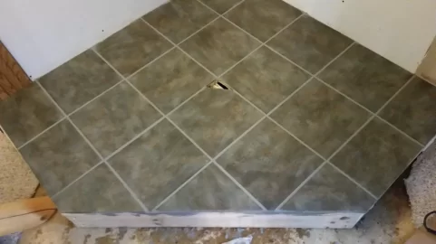

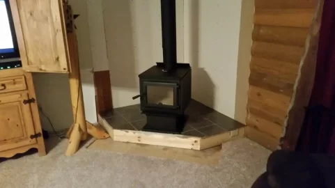

Still need to install the venier stone behind stove and on bottom of platform. Then amber protection in front of stove.
[Hearth.com] Manufactured Home Fireplace to Stove conversion [Hearth.com] Manufactured Home Fireplace to Stove conversion [Hearth.com] Manufactured Home Fireplace to Stove conversion [Hearth.com] Manufactured Home Fireplace to Stove conversion [Hearth.com] Manufactured Home Fireplace to Stove conversion [Hearth.com] Manufactured Home Fireplace to Stove conversion [Hearth.com] Manufactured Home Fireplace to Stove conversion [Hearth.com] Manufactured Home Fireplace to Stove conversion [Hearth.com] Manufactured Home Fireplace to Stove conversion [Hearth.com] Manufactured Home Fireplace to Stove conversion

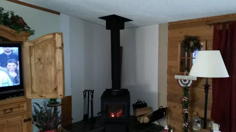

Nice progress, that's quite a change. Is there all new pipe on the stove including the chimney? How tall were you able to go for the entire flue?

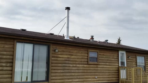

All new Excel system, about 5ft of double wall to the ceiling box and 8ft of Class A Triple wall out the top. Very good draft.
Well done.
Thanks !

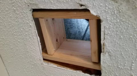

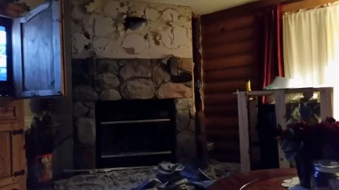

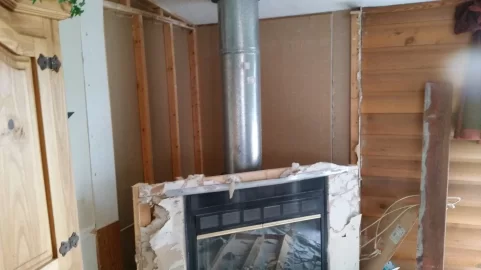

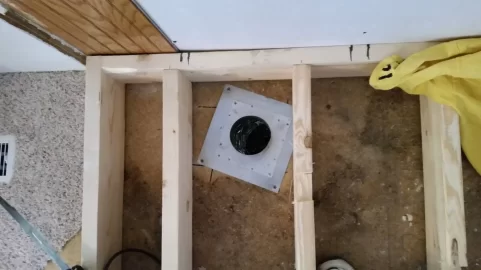

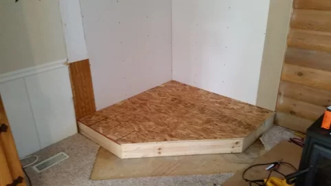

I will put up a few more pics showing the ceiling box and chimney, and of coarse how i trimmed out my awesome popcorn ceiling. lol.. Next project, lose the popcorn. :)
A few more pics.
