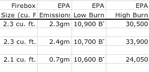

2. The enclosed table shows three EPA tested stoves - all non-cats with similar technology. All have similar size fireboxes (within 10%) and similar low burns. But the high burn varies vastly....and so does the GPH.
One reason is that the manufacturer and the Test Lab technicians are allowed to manipulate certain parts of the testing procedure. I have listed those below......anyway, as to the "trade secrets", it would appear that there are many, and that these have been used by some manufacturers so that they appear to have an advantage, while there actually may be none at all (or the other way around, the higher GPH stove may burn better or cleaner with oak cordwood).....
