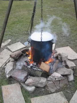

My first setup was simple....a 40 qt. stockpot made to hang off of a chain trammel/tripod set-up I fabricated. Worked good, but was limited to make only a small amount of syrup. Great for a beginner.

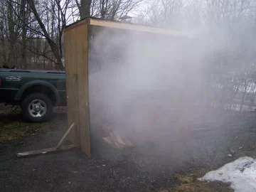

We've made it for years. Small scale and only enough to supply ourselves and to be able to give some away. Here's our "ghetto" setup. Temporary block arch with a 2'x4' flat pan. We preheat and finish in turky fryers. We do nothing at this time of year to prepare for spring.

Love it, DD! That's the best of times right there. Nothing like making something soooo damm good in your own backyard.....
I miss doing the kettle, I may have to break it out again this winter for a weekend. Kettle cooked syrup over an open hardwood fire has the best flavor, HANDS DOWN!
