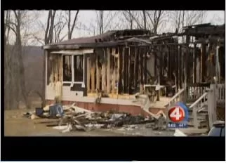

It states the dirty pellet stove overheated and the ash caught fire! Can that really happen if they are not cleaned often?

GERRY, N.Y. (WIVB) - Four people are recovering from a raging fire in the southern tier that is believed to have been started from a pellet stove.
Four people escaped with their lives, but had to be hospitalized, following a house fire in the Chautauqua County Town of Gerry.
Gerry Fire Chief Carl Fransen said, "I was about three miles away; I could see heavy black smoke over all the trees. I knew we had a good fire going."
The victims' grandfather, John Venable, said, "It was just a big ball [of fire] coming out right next to the stairway there, about in the area where that stove is."
Venable is talking about the pellet stove that two sons and grandson used to heat their home. The flames shooting out of the house were so intense, he says, he could not get in to rescue his family.
"[The] bedrooms are all toward the back side, and there's just a narrow hallway to get by. The stove's within three, four feet of the hallway. So you couldn't get through there at all," he said.
Venable's grandson had to jump out of his bedroom window. Not knowing he'd made it out, the boy's father raced back in to find him.
Venable said, "That's when he got burned pretty good."
"Guys did a pretty quick stop on the initial part of the fire. We had about an hour-and-a-half of overhaul. We had a large pond right here in the yard of the house, which helped extensively with water," said Chief Fransen.
The pellet stove hadn't been cleaned out, according to investigators. They believe the stove overheated, igniting the ash built up inside.
Chautauqua County Fire Investigator Scott Cummings said, "You have to maintain them, clean them. Just like a wood stove, same thing. That would really help. And the other thing is smoke detectors. Unfortunately, in this residence, the smoke detectors did not work."

My uneducated guess would be the venting was full of creasote and that is what caught fire.
I would think if the stove was truely overheating the safety shut off would kick in and kill the fire.

Well it is possible for a dirty stove to overheat and the high temperature system not see it.
I really doubt that it overheated to the point it set ash alight (by definition ash is considered non combustible and the temperatures required likely vastly exceed those produced even when 'sote lights up).
It could be a 'sote fire they definitely get very hot and can be the end result of burning a dirty stove.
Remember a clean stove is a happy, safe, and warm stove.
A dirty stove is a potential killer and home destroyer.
Your choice.
Reactions: Eatonpcat
dunno what stove it is, the thing to remember is ash is an insulator if enough was built up it could possibly have tricked the sensor i guess (note this is a guess not an accusation)
I have to agree. If the creosote caught fire in the pipe then none of the safeties would have tripped, right? Remember two years ago, I had a creosote fire at my termination. Scary but I learned a valuable lesson. My stove was whistle clean but I had not looked outside for a while.
