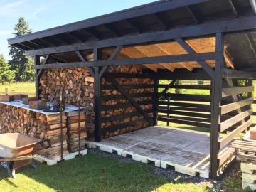

Over the years I've done it different ways. The F350 can carry a cord but time is valuable and I need 5 cords per year. Loading and driving the truck added a lot of processing time. Fine if it's free but it's not.
My current favorite is dump truck loads of logs. It's just about 5 cords, cheap, convenient, and it's waste from a tree service or land clearing operation.
Here is this weekend's load. 14' long logs. Going to fill the 2020/2021 half of the shed.

Those actually look like marketable size logs for dimensional lumber (by today's standards).
Around here you can get tanoak logs cleared from the lumber lands (that which they failed to use round-up on) - great wood but only used by biomass plants, firewood, and wildlife. Eventually I may look into the minimum sized load that can be purchased. A moderate lumber truck load would overwhelm me and risk crushing my driveway.
Thumbs up on the shed.
