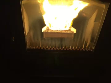

hello everyone. New user this year and had a question for everyone concerning black marks on glass . I'm using okie df pellets great heat no ash but still getting these marks. Are they normal or what should I be looking to fix. Thanks

Do those marks wipe off easily when you clean it?
Hope this helps, but every morning I use a dry 100% cotton rag to wipe off the glass when I fill the stove. And then again in the evening I rarely have any build up on the glass this way.

Ok thanks for reply I will try it .
If you keep the rag handy it take less time to wipe the glass clean than to scrape the pot. Looks nice also,and use protective gloves that glass will be hot .
I was just going to ask that. Do you shut stove down and wait to clean the glass or just clean it. I have always shut stove down and waited for it to cool before cleaning . Thanks for the tip

I open the stove regardless of where the flame is and wipe with a rag REALLY quick.
I don't use any glass cleaner though...glass clould crack so I wait till it cools down a bit before using any Windex or whatever.
I have found that when I get those stains on the side like you do, I have learned to use a rag and do a Quick wipe ONE WAY a few times with some pressure..comes right off.. Harman is know sometimes for the famous Teardrop in the corner of the glass.
back/forth when it;s dry just smudges it up more.
I let the glass cool and simply use a damp paper towel to clean the glass. A little elbow grease and it all comes off. I haven't had to use any cleanser yet.

Looks totally normal to me. As long as it's not getting black and stays white gray color it is fine. Heavy black is an indicator for bad combustion or bad pellets. I have seen how that looks like and you don't have that.

So does this mean the streaks are normal
yes.. I have burned Energex golden pellets 0.5 ash[ the're top of the line clean pellets] and still will get something to clean on the glass.

The marks look normal to me.
To minimize them and extend the time it takes for them to build up, you might want to try ceramic stovetop cleaner. This stuff tends to fill micropores in the glass and make it harder for the crap to adhere. Also, I find that cleaning the slots where the air wash comes out, with a pipecleaner, helps as well. Finally, I seem to remember reading here somewhere to avoid windex and other amonia based glass cleaners.
Simple answer.. Yes it's normal. As stated above a quick wipe with a tag while scraping the burn pot will help when hot.. Otherwise mine wipes off easily with a tag and water when I chit down and do weekly cleaning
