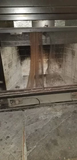

I have a Martin Industries wood burning fireplace model sc36m.
Just trying to find someone to help us locate replacement parts.
Mainly a glass door. Fireplace is also missing the upper and lower vents? Hope that is the proper description
Are there blank panels where the top and bottom vents would be? if so, this may be an SA36 instead. Not sure if the grilles can be retrofitted or if they are still available. The SC36 upper grille is 032076, lower grille is 020362. The glass doors are part WB36.

Odd, the manual shows the SA36 with blank panels and the SC36 with grilles.
We bought the house and those upper and lower panels were missing along with the glass doors. We are seeking any help to help us locate the missing pieces. We considered another complete insert but the finances just aren't there at this time. Then I was directed to get into contact with people on this site as I was told you all are very knowledgeable and helpful.

Parts may be hard to find. Try eBay and Google with the part numbers supplied. If none show up, it would be easy to have the grilles made up of perforated or expanded metal that was cut to fit. They could be painted black to blend in. Here are some glass doors. Email them with your model for a proper fit.
