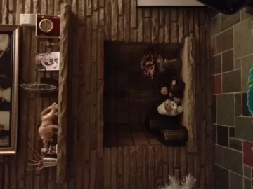

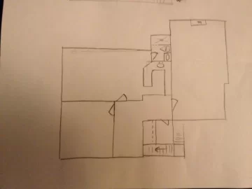

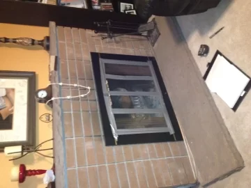

Here is a VERY ROUGH floor plan.. dont laugh.. lol
Also, I have includd pics of the up and down stairs fireplaces.

I to have an older house. A lot of square footage and no space. My basement fireplace sits directly below the main floor fireplace. How much open space in in the basement? Mine has 4 small rooms. A stove in there would have cooked you out. The main floor living room is the largest room in the house and where I elected to put the insert.
edit: just seen the pics. I think that you will cook the room in basement before you get any usable heat upstairs. Might be a good place for a small insert in basement and a larger one in the future on the main floor.Another reason I put mine on the main floor is that I'm hardly in the basement. Bunch of teenagers and kids were down there last time I checked. I didn't want a stove where I wasn't as likely to check on it and the kids could mess with it.

That second FP is screaming for a wood stove, IMHO ;-)

The only issue I see with the upstairs fireplace is that its raised off the ground, so I would need an insert that has virtually no overhang. The Regency Alterra CI1200/1250 would be one of few options. Any other units similar to this?

If you put it in the basement the stove stove is at the far end of the room. It's not impossible to move the heat out of there but I think that room would be cooking hot compared to others. Heat would radiate upstairs but the stairs are at the far end so that would hinder it as well. Doesn't look like you have clearances now in the basement, may have to remove carpet to get the 16" or 18" in front of the stove that you need. As far as it being a dedicated play area. As the kid gets older (toddler) and can be left unattended to play for a while while you cook, take shower whatever you want an area that is as safe as possible. I didn't worry so much about the occasional burn or bump as I did about kids seeing me load the stove and thinking they could do it to or leaving toys and blankets to close to the fire.
The main floor looks like it has tile in front of the fireplace, if so clearance should be good. Depending on the size of your firebox they do make flush mount inserts that would work well.

That upstairs fireplace needs a Hearthstone Homestead in SeaFoam Green in front of it so bad it hurts!

Any other good flush mount inserts that might be really good in the fireplace pictured above? (the all stone one)

Beamer, can you provide the measurements on your main floor fireplace?
My inclination would be to go with a freestanding stove inserted into that fireplace. I would go with a 2.5 cu. ft up to 3.0 ft. firebox if permitted.
To do this you need to consider if a stove will fit in there (and maybe protrude out onto your hearth shelf), where the flue exit is compared to your venting flue position, and whether you would consider a freestanding unit.

I think my fireplace is to small for a freestanding stove. It is only 24" high and 30" wide.
Do not think ?i have seen any that would fit that space??
Now I'm thinking the Alterra 1250 might be to small? It says it only does 1000sqtf max.
