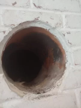

Ok, I'll plan to do this in the future. For this season, can I connect the DVL pipe to my masonry thimble (see photo)? If so, what part(s) should I use?
Will either of these work?
6DLR-MTSC​
Adapter-6DT-FC​

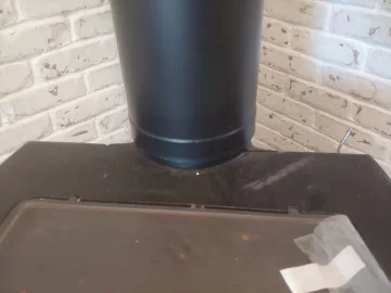

Question 2: Can I connect my DVL pipe directly to the stove collar on my Intrepid 2? The appliance adapter is very loose and the DVL actually fits snug into the stove collar. Is this an acceptable installation (Photo 2)? If so, should I put a few screws through to ensure it stays in place?
Thanks for any help you can provide!

Yes, you can use the DVL directly on the stove. It should be screwed to the flue collar.
