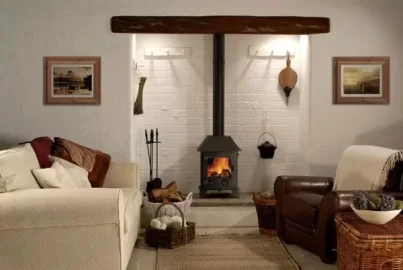

Hello all! Though I am new to here, I have been reading through the forums for the last month researching different types of stoves/fireplaces and insulations. What a wealth of knowledge many members possess!
I tried to find an answer to my question on past forums but was unsuccessful.
We have an Earth Stove Traditions T150C.
Our clearance space on back is 36 inches. With a masonry (standard masonry brick) wall it is 12 inches.
Our goal is the attached pic.
I have two questions:
1. I know I need to leave a 1" gap behind the masonry. Do I need to leave a gap at the bottom of the masonry wall by leaving every other brick out?
2. Should I use hollow or solid bricks?
Thank you for reading!

Just adding:
1. I know I need to leave a 1" gap behind the masonry. Do I need to leave a gap at the bottom of the masonry wall by leaving every other brick out? Or can the wall be floor to ceiling?
Yes, you need the 1" gap on the bottom, the shield needs to be floating. I wouldn't use whole brocks because of the weight. I'd mount the a sheet of cement board on 1" spacers then use a veneer of choice to get the aesthetic look your going for.

I would not float it, but transfer the weight to the floor with a support system that yields the 1" air gap and is mostly open. I would probably want the bottom gap at least 80% open. As mentioned earlier, sketch it up and get it approved before doing the work.
Would 18" work? Instead of trying for a ventilated wall another option is a solid brick wall for a 50% clearance reduction.
If you want a brick wall that is ventilated you could put up a ventilated cementboard wall on spacers, then do a thin brick veneer on that.
Have a metal shop make a ventilated base for the masonry to set on. If you have a welder it would be simple. Couple of flat metal (SS or aluminum would work too) pieces with spacers welded between.
Thank you all for your help! I went back to the house tonight and did some additional measurements. A 50% reduction could work.
I appreciate all the advice and will post a pic when complete!
Best wishes from the Texas Hill Country
Great, they should be full-sized brick for a 4" thick wall and remember that the clearances are to the wall behind the brick, not to the face of the brick.
