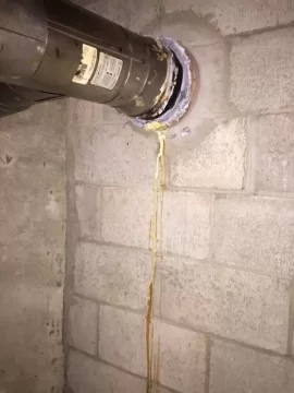

I have a manometer on the 5" oil burner vent not on the 7" wood burner vent. The 7" wood burner vent goes into the 9"x12" masonry flue. I started the fire again tonight and do not smell or see any smoke and I went over the stove and indoor vent pipe with a bright flashlight in the dark as was suggested and saw no smoke. I did however notice a small area of black creosote looking liquid right where the 7" pipe comes out of the back of the stove and a little more at the 45 degree elbow right behind that.

Here's some pics of the creosote and the vent pipe

You will get poor performance (little draft) from a chimney that size. You need a 7" liner inside that chimney. With the coal bed and the current chimney size, you more than likely had zero draft which caused your CO problem. The liquid you have in the chimney is condensation. Your furnace will not have flue temps high enough to support draft in a chimney that size. How is your wood? I have a Caddy and experienced the same issues your having until the chimney was lined. Judging from the creosote and your glass, you either have wet wood or your not burning hot enough. Personally, I wouldn't use it until it's lined. I don't understand why a company would install a high efficiency furnace in a chimney that large, when the manual specifies a 7" chimney.
The wood is pretty dry, it's been split and stacked for over 6 months, hardwood only. It lights up and burns quickly. I think the problem really intensifies when none of the zones is calling for heat and the damper closes which causes a lot more smoke. I'll order up a 7" liner asap. Thanks for the help laynes69.
6 months won't be long enough for some wood, unless it's split on the smaller size, a year is better. Oak takes a couple of years.
This time of year, small hot fires will be your friend. Burn hot and let burn out or build smaller shorter fires.
I second laynes last post. Your wood is WAY wet. Get some ECO brix or the like, or some old pallets to cut up and add to your wood, it will help the fire burn cleaner/hotter. If your wood is Oak it may even take up to three years to dry depending on how/where you stack it. Is your chimney exterior to the house? If so consider insulating that liner, it will make for even better draft and a cleaner flue.
