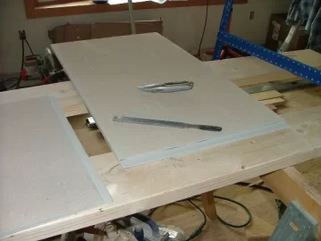

I am putting in a wood fireplace and the specs call for Micore Board or equilivent R factor. So I found a place on line that I could order a 72 x 20 x 1/2 piece, so I did. It arrived but they cut it in half I guess for shipping purposes.
So my question is... Is it safe to use two pieces ? Would it meet the NFPA code? And if so what would I seal the seam with?
Thanks for your patience, as this is a new experience for me.
Bill...
Just an update,
What I did was cut like a over lap between the two half's as I think this will suffice keeping the same thickness and no gap between sheet half's. Also covered it with Durock.
So OK? any thoughts.

The micore is for thermal transfer protection not ember protection so I don't think you have to worry about the two pieces as long as the joint is tight.
Can you post the place you purchased it, a lot of people come around looking for it. Most places will only sell it to you if you buy a pallet full.
Thermal protection is what I kind of thought, that's why the Durock and then on top of the Durock will be a piece of Granite.
