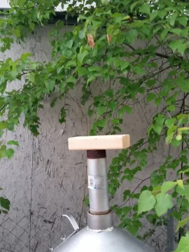

8. Here is all the pro could find that might have accounted for my smoke intrusion.
item one: Smoked to death birch branch over my biggest BBQ cooker, a UDS or ugly drum smoker. This one is a double decker (two cooking racks) thanks to the nice bio-diesel people at Turner Industries dot com. no affliation, don't even ask about shipping to Alaska. No upcharge for 2" flue outlet instead of the usual 3/4" or 1" outlet nipple requested by the folks running their Volvo's on french fry oil. This smoker runs freaking terrific in spite of violating the 3-2-10 rule for tree branches.
[Hearth.com] Meeco Smoke in the stove room update

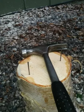

Here is what is left of the birch tree that was messing with the draft (?) on my UDS:
If your browser is working correctly you should notice my neighbor replaced the chain link fence this summer and what remains of the birch tree messing with my barbecue habit is, well, nothing. Dug that SOB out by the roots.

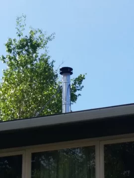

Re #8 above, none of my trees had leaves on them in March when I had the smoke intrusion. After leaf out, I did have one smoked to death birch branch closest to my chimney visible from the street.
As part of the terminal pruning process I did check my records to see when this chimney was put in (before the A30 was in production), and hit the same growth ring counting from two different places on the rim...

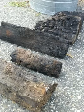

And another thing. I finally got around to emptying the metal trash can I keep wood stove ashes in.
Night of the event, with FD supervision, we dumped the metal can full of cold ashes into a plastic can and set the plastic garbage can with a bunch of cold ashes in it on a couple feet of snow over bare dirt.
Then the firemen carried the now empty metal can into the house. They emptied all the burning fuel out of my stove into the metal can, poured a bunch of water in it, and carried it back out.
I dunno if my pro sweep looked in the metal can or not. I had forgotten about it, until today when I was looking for things that could go to the dump.

I did leave the metal can at the dump. It had visible rust in a lot of area inside, and the bottom felt spongy when I poked it with a stick.
