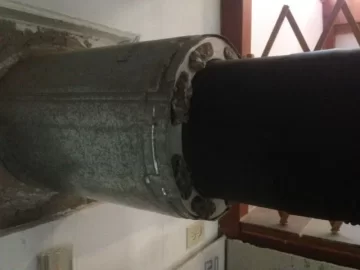

Hello all and thanks in advance for any help. My wife and I just had to replace our beloved Morso 1125 that came with our house. We purchased a Hearthstone Equinox and love it. The problem lies in the fact that our Metal Fab pipe comes through the wall and from what I can tell was installed backwards. The previous stove was installed with a piece of 8" pipe stuck into the Metal Fab insulated pipe. I have been looking into purchasing an adapter but from what I can tell from pictures on the internet they won't lock into the end that I have. This is what I have right now:
[Hearth.com] Metal Fab to single wall pipe question/concern
Do I need to redo the section of pipe through the basement, or make a custom adapter? Thanks again for any insight and inspiration!
David

I attached the file and can see it from my end. If I need to have the picture hosted I can do that as well. Thanks for letting me know.
