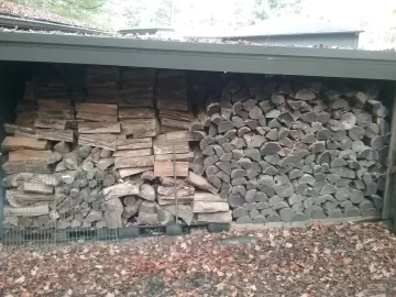

I have three 8' x 8' bays (8 x 24) with 1 in 12 metal roof over them for my shed. They are not sealed and they have never leaked at all. The ribs are something like 3/4" high, so as long as you keep them reasonably clear from debris, the water all comes off and doesn't wick up the overlap. I have to brush or blow my roof off once a year from pine needles and branches and so on that collect.

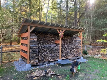

No need just blow leaves off after they've fallen, here's my 12X24 lean to with metal roof dry as a bone. You're good. Open on north and south sides great air flow no problems whatsoever.

Thanks for the replies everyone. I've got it all finished up and full at this point. It's withstood some rain at and everything is looking good.
