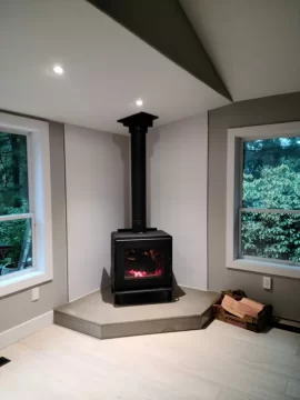

Pictures of the installation, inside and outside, are welcome.

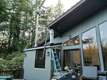

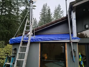

Pics coming once I figure out how to reduce file size. Originally the insulated 6" duravent liner was 13'. With the additions I installed, it's now 19'. The guy that installed it said the 13' was bare minimum. I asked installer if there were issues and he said no. He also said he's installed a few of these Nova 2's. Yes, smoke rollout with bypass damper open. I've gone through the gammit making sure hvac is off, no exhaust fans on etc. Tried opening a window etc. My last woodstove, albeit in a different room, could have the door wide open to add wood. Without smoke issues. The chimney it had was probably at or below the 13'

The picture with the tarp (been in remodeling hell) is the 13' liner. Then the second Pic with actual roof is with a 1' piece removed and two 3 foot sections added.

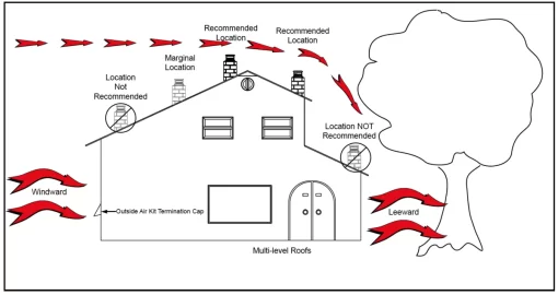

You certainly have tried the common methods to address the issue. Is the chimney located on the leeward or windward side of the house? Single story sections of a multistory house can be troublesome if positive pressure builds up around the cap area. The dealer should come out with a manometer and measure draft to see if is within acceptable levels. Typically this is around .04 to .1" wc.
This article illustrates the issue I am talking about.
