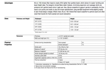

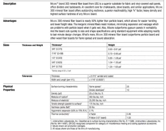

I'm researching Micore and I learned it comes in three flavors: Micore 300, Micore 160 and Micore SB.

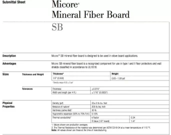

The SB seems most suited for heart applications since it is clearly specified for use as a hearth extension and tested per UL 1618 ,whereas the 300 and 160 don't mention anything about hearth applications. All the stuff I read on hearth seems to indicate Micore 300 is ok to use.
The spec sheets for 160 and SB seem identical.

The SB has a higher insulation factor, but is also more compressible. Micore 300 has a lower R factor but is firmer.
Yup, That seems to be the case.
What bugs me is that only the Micore SB is "listed" for use for a Hearth extension, but everybody seems to use Micore 300.
Could be that it's just easier to get hold of. SB is a limited market.
