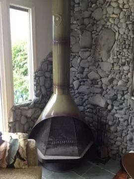

Hello, I recently acquired a Wendell Lovett styled Majestic free standing firehood from the late 70's (?), and would like to convert it to vent free gas log use. The unit was originally a wood burner, and has cement over a steel firebox floor. Some of these units were intended for gas use, others electric, and wood burning.
I am hoping someone has some experience with these units, and can offer advice on the best way to make the conversion to LP gas. How should I route the gas line, drill through the bottom? Run it around the side? Best way to refinish the interior of the firebox, which has some rust showing?
I intend to use this unit with a vent free gas log set, for light heating. I am in Hawaii, at about 2000', so sometimes it gets a little cool. The house isn't insulated, plenty of air flow, so not worried about gases, just want to take the chill off as needed. I am open to suggestions and recommendations, and what else should I be on the lookout for?

Is it rated for a gas log conversion? Some fireboxes are, some aren't. If it's not, I wouldn't do it. If it IS rated for gas, your best bet would be to find a log set that'll safely fit in the firebox, & see which side the gas needs to be fed from, based on where the valve is located.
Stove Bright hi-temp paint can be used inside the firebox, but it will smoke & smell until it cures...
Many Thanks Daksy. I have no idea of the rating. There isn't a tag I have found anywhere on the unit, I have no paperwork of any kind. I haven't even found a manufacturer's name or any identifying info. I have only been able to figure it is a Majestic based on research of images on the internet. From my research the Majestic company was purchased and absorbed into another company. Reports are that they abondoned these units, and they don't have any knowledge available, which is one of the reasons I have sought help here.
I will seek out the Stove Bright hi-temp paint, it should also be a good choice for the screen too. Thanks!

Huh, we thought of doing the same with our Temco (which is in an "enclosed" porch that is leakier than our house). But we just can't bring ourselves to drill it to run a line and bringing one in the front would look kinda hokey, so we never really put much thought into really doing it. for now, it's still just hanging out looking all Bat Stove like (ours is black). These were really popular for a while, seems several companies made them (Malm and Preway I think were the most popular). I see them referred to as MCM a lot but it seems more 70's to me, especially the colors of many of them (oranges, avocado greens, yellows).
What could be a problem with putting logs into one of these though? Weird drafting because it's so open? Just curious. I can't imagine it would be heat, since it was made to stand up to wood burning.
Thanks my thought too, I think the ventless gas logs would not be a problem, especially since I am not after an inferno, just some heat and atmosphere. I haven't ruled out drilling an opening from below to run the gas line, but have been hoping someone else has had experience with one of these units.

Your Majestic looks just like mine, with the three sided front. From the research I have done on the net, it is the 'Firehood' model. Can I ask where you located the tag on yours? I haven't been able to find any tags on mine. I will try to attach a pic from an old ad.
From sources outside this forum, I have been assured that these units will handle gas, that wood burning is higher temperature, and I am waiting to get my vent free gas log set to position the gas feed into the firebox.

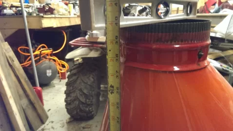

I think ours has clearances of 18 or 24" on the tag (pic below isn't installed and obviously not set for clearances).

I have another question for anyone - I found a kit that goes from the fireplace all the way out through the roof with everything that is needed.
Only issue is that my factory chimney pieces are 9" round and the kits only come in even sizes, so I will be getting the 10" kit.
So I'm working with a local fireplace store to create or buy (if available) an inducer to go from 9" to 10".
What have others done here?
Also the top of my fireplace is crimped to receive the first chimney piece, the fireplace store says it should be the reverse for creosote purposes, but all my pieces are like that.

chris, the crimps always go down toward the stove,as far as your pipe size problem the increaser going from 9 to 10 is the solution if you cant get the 9 inch you need i would put the increaser right on the stove top .

I have installed log sets in these units in the past ,i used a 1 inch hole saw to drill a hole through the back of the fireplace down low to bring my gas into the firebox .If your pipe doesnt terminate through the roof then the top of the firebox where the flue pipe hooks to it needs to be blocked off with metal so no heat goes up the pipe .The size log set will be determined by the width of the firebox an 18 or maybe 24 should work fine for that unit.
