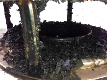

Couple of weeks ago I posted a pic of my filthy cap, few members suggested to run the brush.....ln past yrs my cap has been dirty, but only the cap. The rest of the pipe always ended up pretty clean.
Well, based on suggestions and pure gut feeling, I decided to run the brush. That questionable maple was giving me some uneasy feeling.

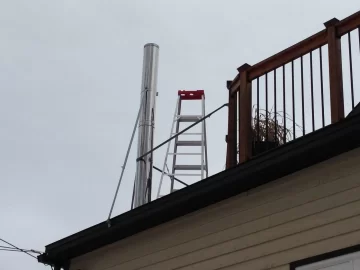

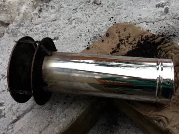

Pic #1 is my set up less the last two feet of pipe and the cap.

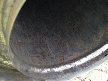

Pic #2 is the section that is always the dirtiest.

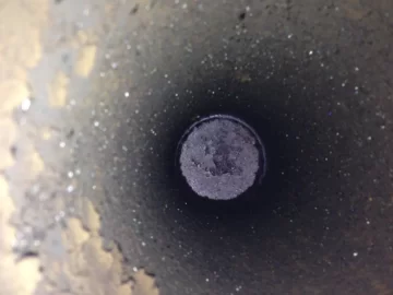

Pic#3 is looking from the bottom of the 2 foot section.

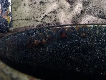

Pic #4 is the filthiest cap I have seen in seven yrs of burning.
Pic #5 first shiny stuff ever on my flue system (last 2" of pipe).
Pic #6 bottom part of the two foot section, cleaned.

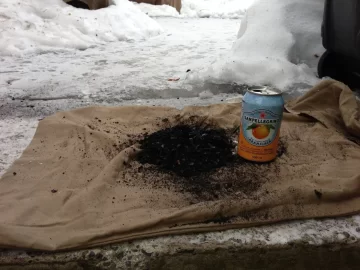

Pic #7 creo from the two foot section (pretty black, no cocoa here).

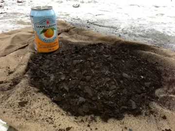

Pic #8 brown flaky creo from the rest of the 22' system.
Before, I mostly used seasoned wood (20% and less). I would then generate this (amount of creo) or most of the time less than this from a full burning season. So, if you gut tells you to clean due to marginal wood.....then clean da pipe!!!
