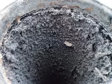

Unfortunately, after about 60-70 days of burning(last week of Sept to first of Dec) this is what mine looks like.
[Hearth.com] Mid season sweep

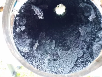

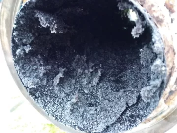

This is what the top four feet of a 16.5 foot run looked like...
[Hearth.com] Mid season sweep[Hearth.com] Mid season sweep

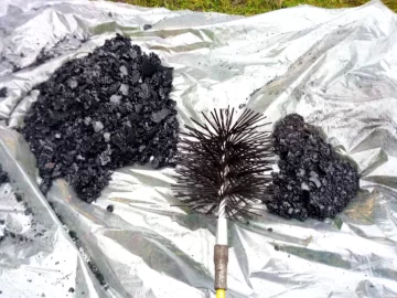

And this is the top of the bottom eight feet...
I thinks my cat is done.<>

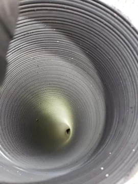

Been burning my new PE alderlea t5 LE insert about a month. Probably put a bit under a half cord through it so far. The picture is taken front the top of my liner. About what I should expect or more build up than I should have?
  • [Hearth.com] Mid season sweep

What brand of tires are you burning in that stove ??
I wish it was tires, at least I'd know what not to do. All of my wood is under 20%, but because our climate is so temperate through the winter we tend to burn low and slow.

Given your location. Your wood MC must be in the upper 90% in order to get a chimney looking like this.

Thanks for the reply. I'll keep on keeping on then
Looks almost new. How much wood have you run through it? How has the stove worked out for you so far?
Just shy of a half cord of red oak since it was installed December 1st. I'm very happy with the stove so far. Really no complaints at all. Very easy to get a fire going, air control is responsive, glass stays super clean, coals left in the morning for easy reloading. Throws a ton of heat. My house is a 2 story colonial with an open floor plan, about 1800 square feet. Heats the house very well without having to push it at all. We havent had too much cold weather the last month so am waiting to see how it goes during jan/Feb. Coldest weve had was about 15 degrees and it did great. Really just a great stove. Went with it due to a lot of the good things I've read here on the forum. A great place to learn for someone new to wood stoves like myself.
You would think so. We tend to get 4, popcorn dry months, June through October that gets most of my Doug fir to 20%, cedar even less. Then it gets stored for 2-3 years before burning.

@AlbergSteve , how old is your cat? That is a lot of deposit.
