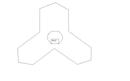

Here is a basic floor plan of the house with a picture showing the location of the stove in the middle. Let me know what you guys think and sorry for such a long winded explanation.
  • [Hearth.com] Might need a new stove what to do?
I would suggest posting a couple pics of the current hearth with dimensions, as well as approximate dimensions (sq ft/volume) of the home. Seems like a pretty unique home, pics of that would be interesting as well.

Is there a ceiling fan in the center room? It looks like the house has a lot of exposed surface area. This doesn't seem like a practical design for cold country. How has it worked out?

Pook brings up a good point, it sounds like you might have some type of MH. If so, keep that in mind should you decide to replace what you already have. Pics and more drawings of the design could be helpful.

Hello again guys and thanks for the ideas. As for the home its actually in Joseph Oregon....I am up in Alaska working right now and have no access to home to get pictures. The house is 2,400 square feet and the center hearth is actually an open design inside the octagon room. There is a fan upstairs that blows into the room bringing all the heat back down then dispersing it out the vents. The bricks are not actually encasing the stove its only two bricks thick or so and the stove is actually accessible from inside the room. That's where the damper, water heater and the fans are located. I believe you guys are probably right about the radiant style stove, a catalyst style probably wont pump out enough radiant heat for me. Another stove that I just stumbled upon is the Hearthstone Equinox, that looks like one seriously great stove and it would radiate a lot of heat along with a huge box. My current stove is probably twice that size but looses a lot of heat out the stack. Something like this might work because it would radiate the heat and burn better. All my logs are cut to 20" inches and I have around 8-10 cords stored up on my 26 acres. So at least I dont have a big pile of waste if I bought a new stove.
