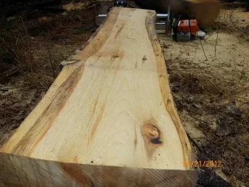

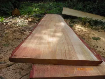

I think I like the Hemlock grain over the White Pine.

SJ, would you not sticker this wood? Seems like the boards will warp if standing against a wall for a while.
Zap I envy you. I have a whole woodworking shop out back that I haven't had much time to spend in for the last two years. I just recently starting to get back out there.
FWIW when ever I build something using a wide board like that I was always told it is best to rip and re-glue it back together. When drying something like that there can be a lot of stress that can cause it to crack after you bring it indoors in a climate controlled environment. Most likely after your table is built. Also when I dried fresh milled wood I would sticker it and add some weight on top to help keep it from warping and cupping. Also paint the ends with a latex paint to keep the ends from cracking.

They will cup unless you wax the ends good and then stand on end. This keeps pussure off the middle. (Big slabs need to be on end) Legs where mini milled. (From a 3 inch slab) One table took 2 slabs.

Depending on the weather I'll be heading back in to pick wild leeks, when I'm coming out I'll measure the topped off Hemlock which I plan on milling, should be big enough for the coffee table.

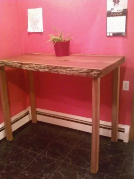

Nice table SJ. How did you attach the legs?
The legs are so long (Pub style) I used a heavy duty couch leg hardware, so it could be move into that little space.Or out far as that goes. lol Kitchen table leg leavels on the bottom.

Stax, weather permitting tomorrow the topped off Hemlock is coming down which I plan on making the coffee table out of. I settled on three inches for the thickness.
Around the corner from that is a topped off White Pine which is coming down after the Hemlock, I want a three inch slab from that which can go on the porch for a coffee table. If the wife likes the pine better than the hemlock we can switch it out.

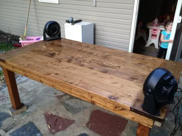

Zap. If your gonna sand after you stain and before your poly, I'd maybe go a little darker with the stain. Although I'm happy with the color of my stain, it isn't exactly what it looked like after the first time I stained.

Since the picture, I've sanded, re-stained and hit the wood filler spots as well. Putting another coat of poly on tonite.

The table looks great, for the color of the stain I'll leave that up to the boss.

A tip to remember when finishing a table:
Make sure you put the same coating on the top & bottom. 3 coats on the top then 3 on the bottom, 5 & 5 ... etc.
No matter the finish used, it is not totally air tight & the moisture in the air is going to cause it to swell & shrink.
If one side has less finish, it will swell & shrink faster than the other side & cause it to warp or dish. ;)
One of Dad's rules for drying his good wood:
Wax or paint the ends. It will help it dry more evenly on the ends & reduce splitting on the ends.
His rule of thumb for drying hardwoods, 1" per year, 2" thick green board takes roughly 2 years to dry.
rotate & flip the boards every 3 or 4 months.

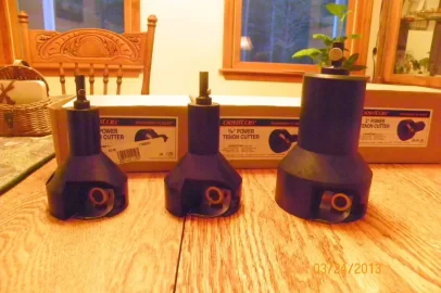

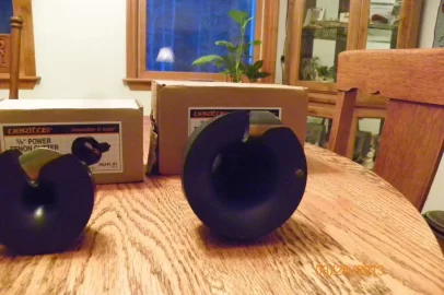

I bought these last fall but since most of the stuff for the coffee table won't be ready until this fall I left them in the box. I bought three sizes, 3/4.5/8 & 2 inch.

Did you buy them as a set, Zap? How much were they (if you don't mind me asking)? I'd like to get a set of those, and matching forstner bits....
