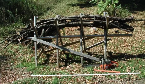

I built a sawhorse divided into 21" sections, with a length indicator 21" off the right end. I have an 84" measuring stick and I buck the trees into 84" sections which I then stack and gang-cut on the sawhorse. I'll throw on longer sections as well. In that case, the 'tails' are placed on the horse again as part of the next batch. The orange 21" measuring stick is for logs that are too large to handle this way.
