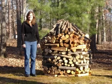

I decided to make a holz hausen today out of some unstacked splits. It is pretty pathetic both in size and quality. I knew I didn't have a large quantity of splits available so I started with a smallish base. I'd say it is no more than 4' in diameter. I did put it in the upper yard in case any neighbors recognize it for what it is.
I think one this size made it harder as there wasn't as much space on the inner diameter to rest the inner end of the split. It made my inner portion grow taller faster and I had to keep adding sidways splits along the outer circumference to keep the right angle. I am a bit dissapointed in my results but at least I got the wood stacked somehow!
  • [Hearth.com] Mini Holz
Good job.
Good use of small amount of wood in a small space. You will find making a larger Holz will be a bit easier due to side pressure to aid in verticle support.

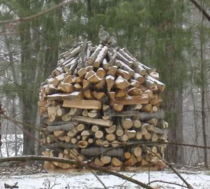

The holz is adding a lot of ambiance to the yard already...
You may soon find birds and squirles making a rest stop there.
Look at the top of my last pic! That squirrel probably thinks he has a vault to store his nuts!
That's cute. Kind of like a wood Pagoda. Looks like about 1/3 of a cord. It's amazing how much wood is consumed building a holz.
You almost have to put something next to a holz in a photo or it's hard to figure out just how big they really are.
I agree that a bigger one is easier to stack regarding the use of horizontal spacers to maintain the downward and inward orientation of the bottom rows. You also get a feel for how to stack without using those horizontal pieces on your first one. I managed to avoid using them completely building my second holz.
