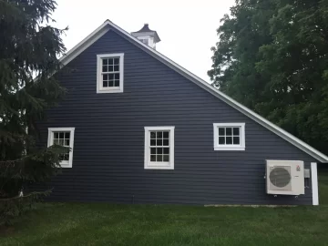

![[Hearth.com] Mini Split AC [Hearth.com] Mini Split AC](https://www.hearth.com/talk/data/attachments/159/159093-d9d7acdcabaf07eb6480cf8eb9e072f2.jpg?hash=oJLAhwor0K)
