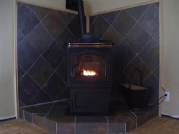

I went off the diagram on the bag of the stove, on the corner install it's a minimum of 9" from each corner of the back of the stove (not corner of the hopper) to the wall, if you use that minimum 9" the back of the stove is within clearance also. Being a corner install i built the pad to fit the room and placed the stove where i wanted it having plenty of clearance. doing this before putting down the hardwood was also easier, no mess to worry about.

Hemi the hearth looks awesome. I should have mentioned that the corner install is to be temporary for me, that is why I looking for the minimum clearances. I'm planning on taking down a wall in my living room to make a more open floor plan and will build a more suitable hearth at that time. I'm guessing the 9" from the back of the stove to the wall is really the only clearance I need to more about other than the floor protection. That is what has me baffled since Harman seems to be giving different measurements.
