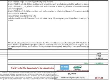

So I finally got a install date for my heat pumps! After extensive research I decided to go with mitsubishi hyper heat they just can out with a new fs model that is supposed to be even better the the fh I guess. I'm getting thre
e single units for better efficient and it was actually CHEAPER than to buy one multi zone and a single! I'm going with a 6k in the bedroom and 15k In my living room and a 12k for my basement. I think I got a smoking deal 10,900 installed including electrical work with a 12 year warranty and they're going to evacuate and remove my existing mini split that isn't a cold weather uint
Did you get the rebate on them from Efficiency Maine? I remember reading last year they were increasing it to $1k per ton.
Yeah for maine it's based on hspf of the unit it's a two tier program with the maximum rebate of 1500 dollars. To get the 1000 on the first unit it has to be a single zone over 12.5 hspf and samenwith the second to get the 500

With the rebate it will end being 9400 hundred and that includes all the electrical work and removing one existing system I think I did very well. We got the quote same day and book for three weeks from now.

Which Mitsubishi models did you get? Have any model numbers? I can look up the cold weather performance for you on the cold climate New England NEEP list.
That would be great I tried to navigate that site but I found it to be pretty tricky.

Here are your 3 units on the neep site. They all have really good performance even at 5 degrees. If you look at the maximum capacity tables you will see that they can actually put out way more than they are rated. That 6k unit can lower all the way down to only 640 btus. That's an impressive capacity range.

Efficiency maine requires professional installation to qualify for the rebate. I was thinking of self install but I figured it wasn't worth it. You get a 12 warranty if a diamond mitsubishi installs them. It was worth having them sized correctly, I would have installed a 18k btus in the living room and basement and at an efficiency standpoint its not as good as the 15k and 12k. For some reason the smaller output the more efficient.
