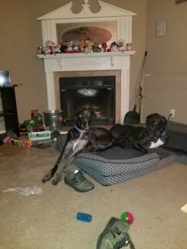

It's in the corner of the living room. Excuse the mess. It has a blower but it doesnt really work. Turns on but doesnt actually pump any air. I would like one with a blower since I know multiple people with those in mobile homes and they say that the gas bill is almost non existant. So that's as far as I have gotten with what we want

There isn't a lot that can be done to improve this unit. Does it have the glass doors?
The blower should be pulled for servicing. With dogs it's possible that the blower is full of hair. If so that will slow it down and reduce output. The cheapest thing to do is to pull the blower and clean it and the blower cavity thoroughly. Oil the motor if possible. That might be all it takes. If the blower is shot and bearing starting to seize up, then a replacement blowers is available for under $100.
The alternative for better heat would be to tear out the fireplace, replace the chimney, put in a new hearth and a modern stove that is mobile home certified. This might be hard to do for under $3K unless this is a DIY project.
Yes it does have the glass doors. And we didnt know it had a blower till about 2 days ago lol been here 2 years and never knew. I'm gonna pull the blower tomorrow and clean it. What kind of oil should I use to lubricate.
Lightweight motor oil like 3n1.
