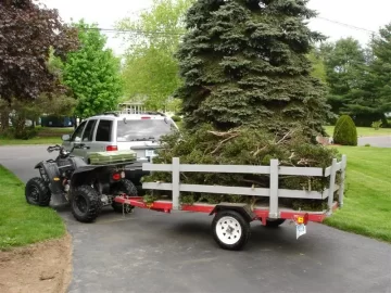

I primarily use this trailer to haul my quad and take brush to the dump. The side rails worked just fine for that.
Brush run, taken last spring:
And a "before" shot of just the trailer:

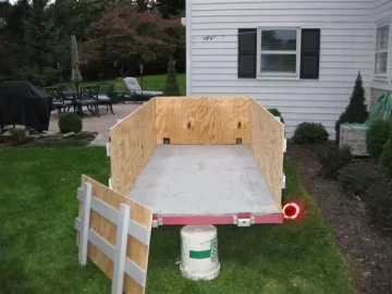

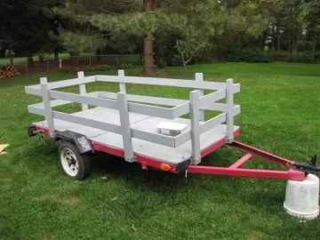

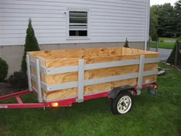

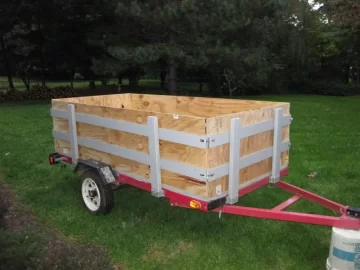

I had luckily built my side rails 2' high. So ripping down 2 sheets of plywood was all it took. I was able to have the guy at the Depot do this. I love going there at lunch on a weekday...no crowds.
Here it is all atogether. Yes, I'll be painting that eventually.
Total cost for this addition....$25 and a little time.

I like it! Nice job.

That first picture looks like you put that whole pine tree in the background inside the trailer!
lol, that was the first thing that struck me too. Amazing shot.
