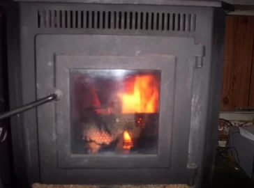

basket with sawdust

Saw dust = no auto feed system. You have to manually lad the basket? Kinda defeats the purpose of the pellet stove with a hopper.
Maybe get a wood stove with only natural draft to burn saw dust? use the 111 you got as the feed sytem.
sdust jams the augers & aint dry enuff to burn smoothly. if it gassifies & ignites= boom! i think thats what cracked my stoveglass when i wasnt looking. furnace cement sealed it well.
