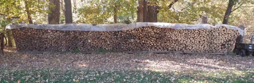

I have a very long single stack for "just split" before it goes to two locations near the house. I've had excellent luck top covering with clear plastic 2" wide and however many feet long. Since it's not direct sunlight, I'll get 2-3 years out of the plastic since there's no UV to speak of.
There's a clear difference in the top 2-3 spits under the plastic than further down the stack. I use a staple gun to tack the plastic down to the sides of the stack. This shot is from 2015 and I'm going to use the same plastic again this winter. Seems to stay on in most all weather.
What is the difference between the top 2-3 splits and the lower layers? Are the top layers drier than those below? Was thinking about a similar setup myself.
I would think so also.. with that huge long pile I bet the 1st 2 or 3 split rows equal close to a half cord of wood
as it warms vapor rises so the top area ( with plastic down over the edge) will hold that vapor creating an environment not great for drying. if there is enough wind a lot of the rising vapor will be blown out the sides as it rises. so you need sufficient clearance between stacks to allow this to happen. its always a challenge to set things up to dry properly with in the constraints of urban areas and the local gov. regs. Even more so when they tell you what amount you can have on hand and other various ludicrous rules created by those with no knowledge in this area. ( me I got the x out of dodge- had enough of the regulation pasture droppings)
The top few spits under the plastic are always drier than those further down. You pick them up and get that "weightless" sensation. It's got to be the result of a little bit of sun and NO rain.
Reactions: JSeery
I added another 8' last year, primarily, just because. ;) And I certainly have scavenged the top row when winter hangs on longer than expected!
With the system I've been using the top layers are the driest. These fiberglass roofing panels let the infra-red heat through and also concentrate light breezes through the stack (especially the top). The bottom layers by the ground stay drier than with tarps because tarps deposit all the water from the top to the ground around your pile, increasing soil humidity. These corrugated panels channel all the water away, to the end of your pile.

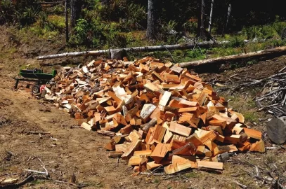

This photo was taken near noon but it's red (like a sunset) due to all the forest fire smoke in the atmosphere. During actual sunrise/sunsets I saw colors I've never seen before. Now that it's been raining for the last 3 days, I can see a nice dry spot all the way around the base of my stacks that I never had when I just used tarps.
I agree about the vapor rising up, but I loose you there, I would think that it rises, condenses on the plastic and rolls off the plastic, sparing the wood splits for gaining extra moisture.
Horrible that you guys have fire problems, but beautiful picture, love the lighter / brighter colors.
