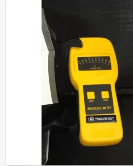

What should a douglas fir 2x4 (not one of the cheap 'green wood' ones) read at? All of my wood is rating very high with my moisture meter so I thought i'd try on some known woods. I have a Travis Industries moisture meter that I received with my insert so I can't check amazon reviews on it or anything like that. It has a low button that ranges from 1-15% and a high that ranges from 16-35%. Note the readings overlap as shown in the pic below so if it shows 35% that usually means it's over 35%.
When I poke it into a 2x4 it maxes out at 15% on the low reading but shows nothing on the high. I poked it into a cheap piece of ikea pine furniture and it gave no reading at all, and I poked it into a piece of outdoor wood furniture (unknown kind of wood) and it showed 27%. Seems like everything is reading high to me. Any thoughts? I have red oak that's been split and stacked since march and it still pegs out at 35%.

Go to lowes/HD and get a new one. Will be worth the $20. I think General is the brand that they stock.
I have the same one. If it maxes out at 15 on low and shows nothing on high you're at 15%. The low button is for 1-15 scale and the high button is for 16-35 scale.
Yeah I understand that part and how it works. I'm asking if mine is faulty. I thought Doug fir 2x4's would read more in the 10-12% range. All of my wood seems to read too high.
Interior unpainted trim should be in the 10-15% area. Your palm should be low 30's,
May be that the outside wood has absorbed some humidity, gotten rained on, etc. 15% on the Doug Fir doesn't surprise me if it's been outside, even covered. 35% on Oak doesn't surprise; It's one of the slowest-drying woods around. It needs two years split and stacked, maybe more if it's from a live tree. Did you re-split the Oak and test on a fresh face in the center of the split?

The good ones (used by woodworkers) are expensive, but the cheapies are good enough for testing firewood; Harbor Fright is probably the cheapest at about $15. The "General" I got at Lowe's was a little under $30. Or there is a sticky thread at the top of the forum with a method for using a multimeter. There may be a 2-3% correction factor on some species of wood.
You can test your meter with a resistor. After all it is just an Ohm meter. Mine came with a test resistor built into its cap. A 1 MΩ resistor should read in the low 20% range based on the chart in the multimeter for moisture content thread. (Assuming your tines are spaced as specified in the chart.)
