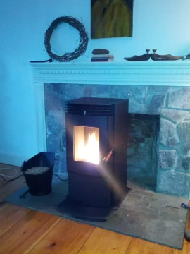

Thanks for everyone's help on diagnosing my Montage. I pulled it completely apart and cleaned it. It appears that there was some build up behind the combustion motor wheel that may have been causing some issues. Did not buy the combustion motor after all. I have been running it the past 2 days and all seems good. The dirty motor combined with the elbow clean out that was full seemed to be the issue.
As for the new stove, man is it quiet. Pretty much have the new stink gone and it is running on high right now. Spent money this year I was going to next year, but kind of glad I did it now that I know how quiet this thing is. Hopefully cleaning will be easier to. [Hearth.com] Montage is out and Mini is in
