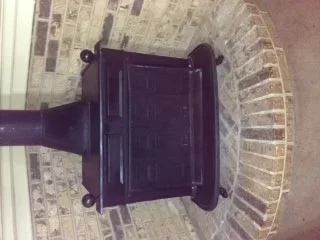

I have the exact same wood stove. It was in my house when I bought it 19 yrs ago. My insurance just cancelled me because of it. It's not U.L. rated. Had to get a new insurance co. I've always used it as a fireplace & kept the doors open when burning wood. I have a screen in front. Only time I've had back draft smoke come in the house was when we had a lot of wind. Had a chimney sweep come out yesterday & give me the low down on certifications. This stove is too old to be U.L. rated. My chimney is good but the pipe from the stove to the ceiling is not a double wall. That pipe is also straight...no curves. He said that back draft can occur if the chimney is not tall enough. I'm getting a quote on replacing & getting double wall...which will be certified. I have a brick wall behind & under the stove...but only 24 inches clearance...should be 36 inches. I would be very careful with yours being so close to wood. I have enclosed a couple of pics of mine. Good luck.

There is no reason whatsoever to spend the money on double wall pipe for that stove single wall is just fine
Replace the old Franklin stove with a modern unit. You will get a much more controllable, efficient and attractive burn plus more heat.
Looks kinda like one of my first wood stove setups minus the pipe. My stove was called a Franklin Stove and I had those white pretty rocks. The stove was a gopher stove in that you had to add wood like every 2 hrs or less. Overnight burn forget about it! I'd def want a more efficient longer lasting wood stove. Also those rocks will get dirty and are impossible to clean lay a proper hearth or bare min. a fake metal one. On the walls attach 2x4s going straight up and down with say a 12" gap between, cover with something like firecheck drywall or that fake rock stuff. Leave a 4" or so gap on the bottom and top so air can wick up between the drywall and the wall. I'd just enlarge the hearth and move the stove further out so hopefully so can get a straight run of chimney pipe. Don't want to make you feel bad but your whole setup sucks from bottom to top. I kinda think it was just done for looks.
Shorton1s setup while not perfect is way better than yours bare min do what he has done.
