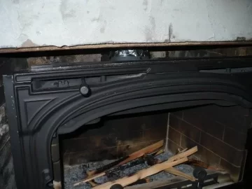

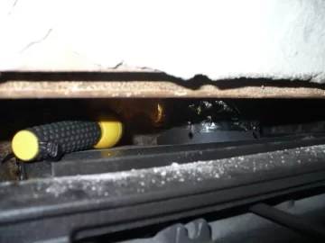

Wow, I did pull off the baffle/surround and I can see it's only halfway connected..It's in the same condition it was before, it's misaligned just as I'd witnessed earlier. Part of the liner's inside the stove, the other half is not. It gaps up to almost an inch before it narrows back down. I need someone to hold a flashlight on it while I try to take a picture, the flash on the camera's not doing the job. Now I know why he was in such a rush to get it pulled out yesterday after doing the match test which didn't draft well either. Evidence of this work will make him look bad if tech support had to be called in.

Sounds like a little investigation is in order. With 23' of liner on the insert, it should be drawing better. I would remove the front shroud and also the baffle as suggested. That will allow you to inspect and get in there with a hand mirror and good flashlight. Try to look up the flue from the inside using the mirror. Then shine the light towards the flue collar on the top outside of the stove. If you are seeing big gaps (light leaks), that is at least part of the problem. Then try to shine the light up the interior of the flue and see if there are big light leaks visible on the exterior flue collar. Then using the light up the flue, try to use the hand mirror to inspect the liner from the inside to see if it is badly dented.
If you find major gaps at the flue collar they could be a cause of poor draft. If you find both conditions, air leaks and a dented liner, then that is the likely cause of the problem. If they tore the liner and taped over the tear, it needs to be properly fixed. Metal tape is not a proper fix.

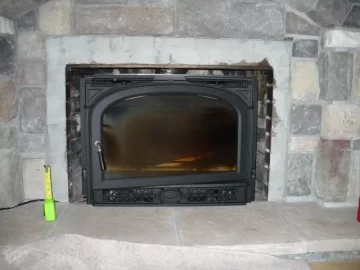

yes it's a tight fit, which I'm sure is to blame for the work. The contractor came out and placed an exact mark on the old fireplace brick that he could live with. The mason came in and built a new cultured stone fireplace and gave the contractor even more room than he asked for, maybe a half inch more...but it's still tight. I'll take a picture of it and post...The mason could have worked with anything the contractor wanted so the blame is with the measurement provided to the mason. If there's no room to make this work (and this is where I need one of you installer's opinion), then I would have to hire the mason again to lower the hearth, but that will mess up the stone work he's already done so I'd like to avoid that scenario. Let me see if I can get the pics posted...OK..well the pics I took are about 3 mb so I have to figure out how to reduced their size...not my thing...so maybe I can't show you what's going on...

guy probaby did not know what he was doing. he must have tried to snake the pipe down onto the outlet with the stoe already in place. that insert has a unique install system; first the outlet is connected to the inside of the stove by a few bolts. the nuts are inside the top of the firebox. you remove the baffle, take off the nuts, and then take the flue collar off. with the insert NOT INSIDE the fireplace, you connect the liner to the outlet. The outlet has a handy handle/brush guard in the middle. push the outlet and liner back up towards the fp damper area, and roll the insert in (yes roll... it has wheels on it). then reach up thru the stove's firebox, grab the handy handle on the flue collar, and pull the collar and pipe back into place. reattch the nuts, and reinstall the baffle. tada! done! no prybar needed!
