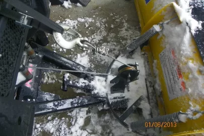

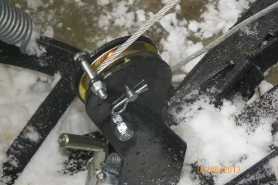

The first year with the Moose Plow I broke the cable a few times (just a bad setup) last year I never had to use it so at the end of last year I bought this kit.
The area I just plowed, in previous years the cable would have snapped, this setup is a must.
In pic 6651, so you can run the cable through the pulley wheel you just remove the cotter pin,pull the pin to remove the wheel, run your cable in then put your pulley wheel back in.
Your plow drops nice & slow with this setup, saves on your winch.

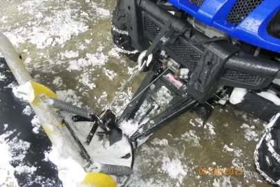

I stopped in at our dealer who sold us the Moose Plow and the Pulley Kit, after this last snow people had snapped the cable so much they called the dealer up asking what they could do for them, they sold 4 Pulley Kits.
I guess a couple of them doubted him, he gave them all the info that I told him plus ask them if they wanted my number (not home number, I gave him the ok) so they could confirm the info, they never called but placed the order with the dealer.

Mine wears the cable where it goes thru the fairlead & it breaks there once, sometimes twice a year.
Mine is out of the fairlead, straight down to the plow frame. Cable has a 90° down turn over the lower roller to the plow.
Cycle country plow.
